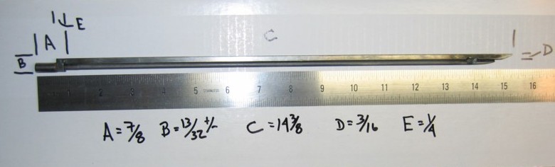

PostPosted: Mon Jun 12, 2006 3:20 pm
Hey Todd,
I have a luthier friend that makes mine for me. They are single action though, but I can get any size made you like. They look like this:
Some people want double action rods and I am not going to argue with their preference but the makers I know that use these are happy with them.
Good Luck Todd, it looks like you have a few options now.
ShaneShane Neifer38881.015162037

PostPosted: Tue Jun 13, 2006 8:56 am
Shane, I don't see why that rod couldn't be made dual-action by simply ensuring there's enough thread on either end of the threaded block. Twist one way, bends one way, twist the other, bends the other. Identical-looking to a number of dual-action rods...
PostPosted: Tue Jun 13, 2006 9:46 am
Hey Mattia, I think it could but they are just built a little different. I am making a dedicated guitar making space, while I wait to get the rest of the materials for my new big shop, so once that this little studio is done I will start to make some double action ones as well. The guy I get these ones from sells them to a number of smaller independant but fulltime builders and they all like this style over teh double action. They claim that the double action rod is just too easy for someone who isn't sure what they are doing to cause some damage to the guitar (the purchaser not the maker) and that this rod offers more that enough movement to do the job. But there isn't no right item except the item a person wants!
